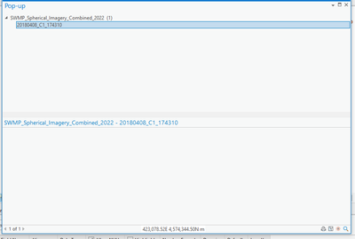

I am having issues displaying pop-ups and I'm not sure why, any suggestions would be greatly appreciated. No fields are displayed on a pop-up despite them being configured to do so. I can confirm the fields in the attribute table are populated so there is no reason for them to not display.

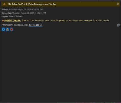

Thank you for the reply. I tried this and am still encountering the same issue. If it helps to narrow down the potential cause, Messages on warnings after running tools don't display either (see attached image). Using "Copy all details to clipboard" button towards the top right works, however, so the messages are stored somewhere, they just aren't displaying.
LJackson29
Hi -

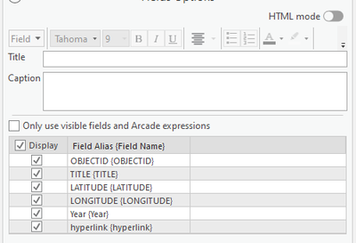

Was there a resolution to this issue - I am experiencing the same issue in ArcGIS Pro since I updated to 2.9 last week. It is occurring on all layers regardless of location: file geodatabase, enterprise GDB, and Portal.  The pop-up is configured correctly I believe and the fields visible. See snapshots below:

jaman
This topic is old at this point, but for anyone that comes looking for the solution, this is what worked for me.  https://support.esri.com/en-us/knowledge-base/problem-pop-ups-do-not-display-the-attribute-informati...
The fields were minimized and just dragging up the gray bar in the pop-up window solved the visibility issue.
