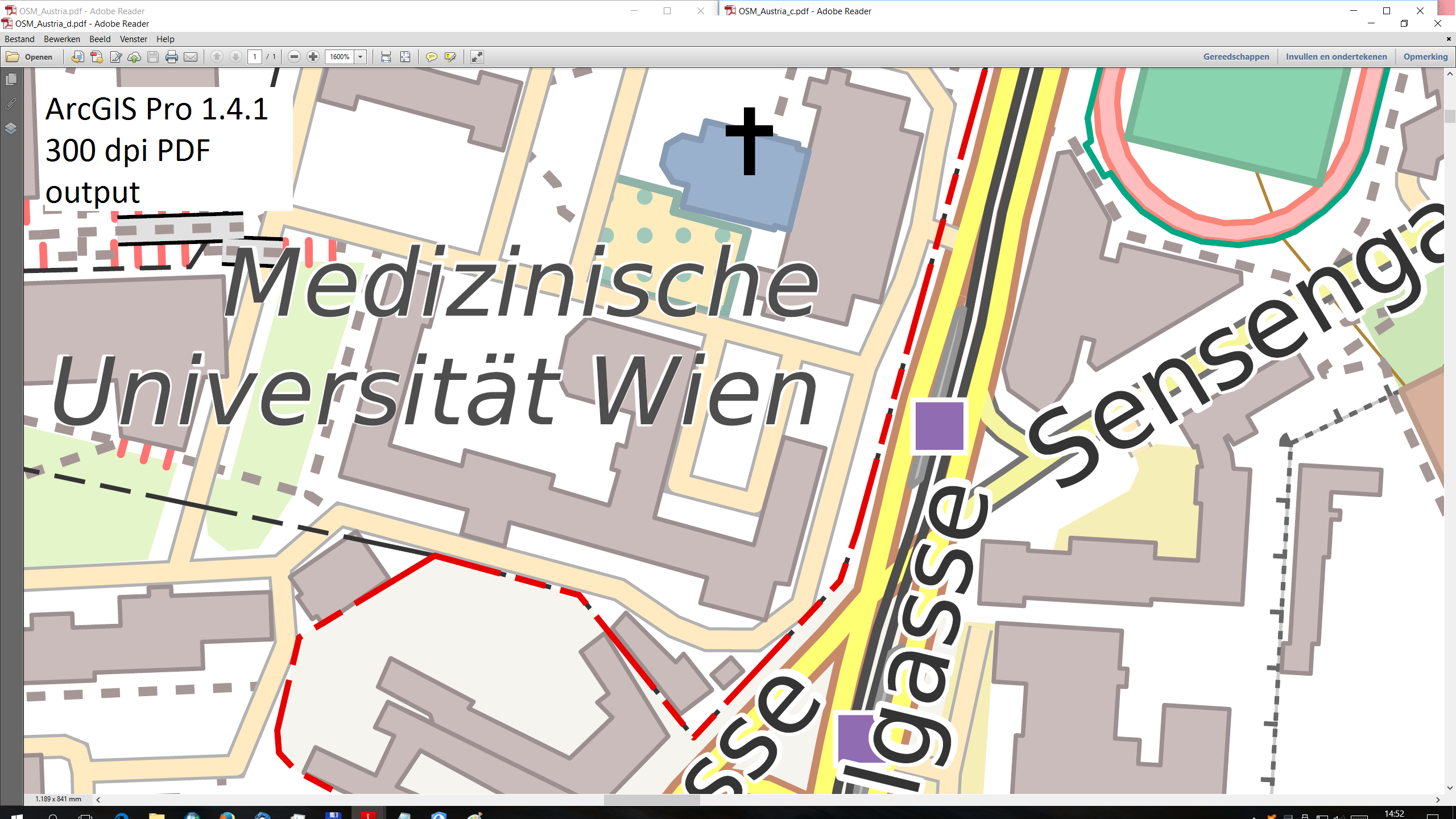

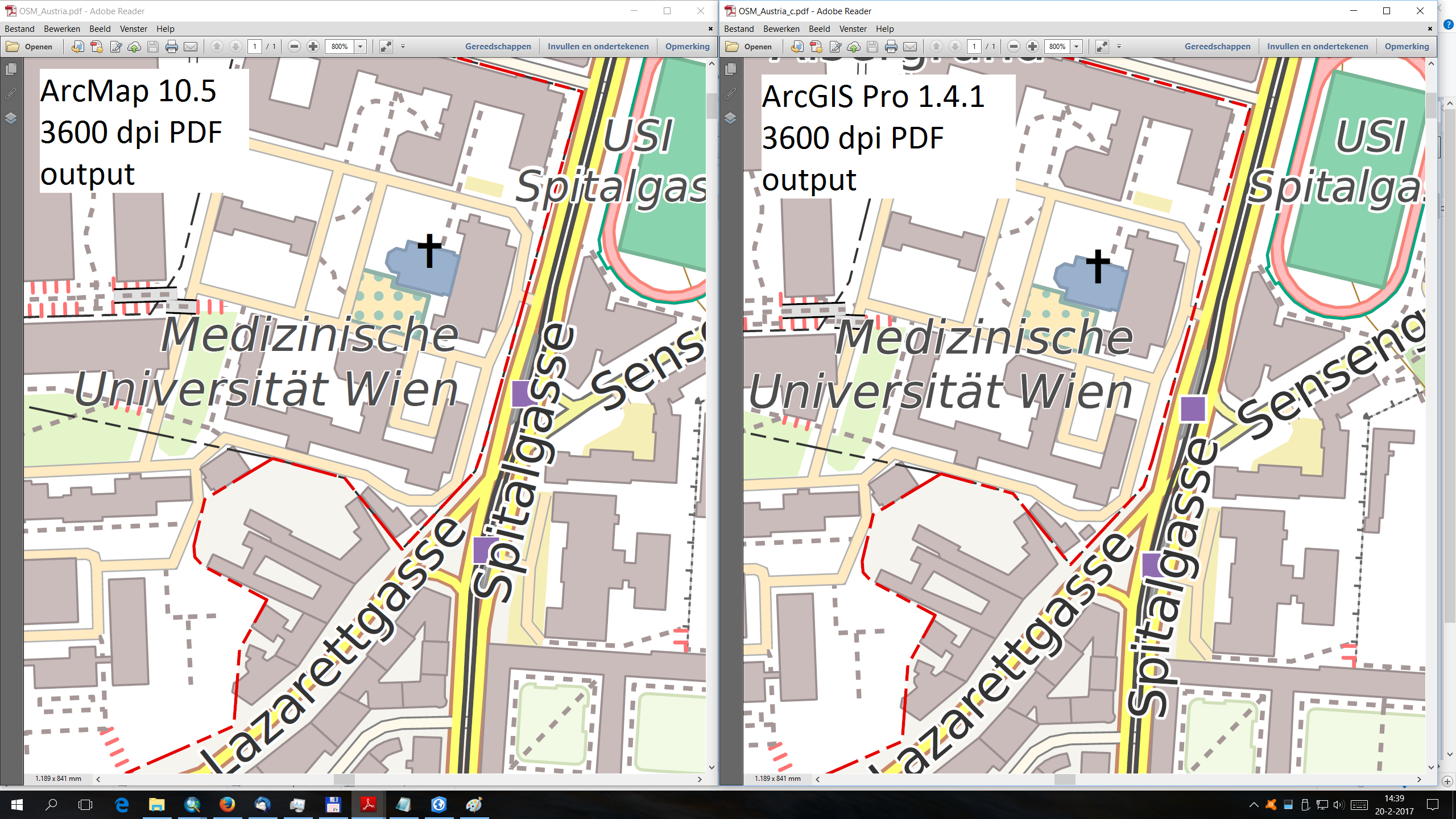

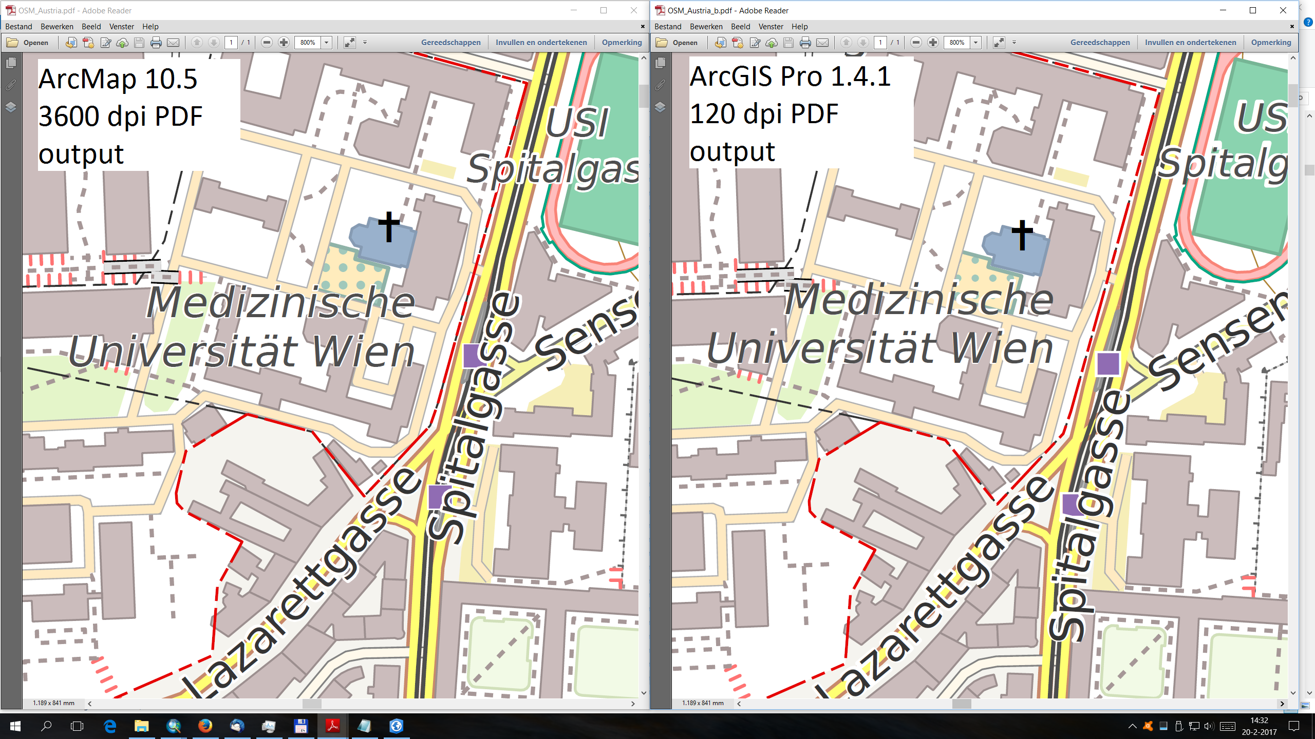

Unfortunately, not for the text label halos though!... Look at the accompanying images (note: 800 or 1600% enlargement), which shows both a high res ArcMap output, and Pro output at different resolutions. Notice how at 120 dpi, the halos are rendered really poorly. Instead of nicely encircling the corresponding label characters, the halos appear skewed, shifted and e.g. the "i" dot is square instead of trapezium as it should be for the italic text.

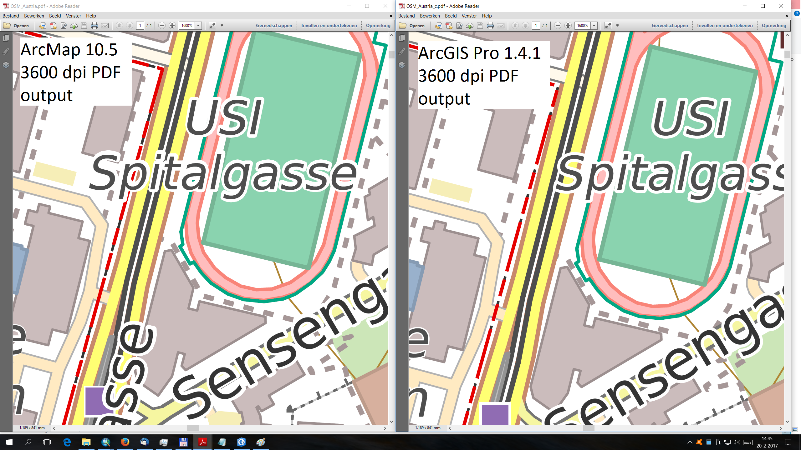

Notice that with a 3600 dpi setting in Pro, the issues are completely resolved, and in fact, the halo rendering is even better than from ArcMap at the same resolution.
However, a not unrealistically low 300 dpi setting, still leads to big artifacts in the halos... This will be an issue when exporting combined raster + vector data, where you may wish to reduce output size by limiting the dpi setting. As for now, this will lead to poor text halo quality in the PDF output.

Poor text label halo rendering - ArcGIS Pro 120 dpi PDF output
Poor text label halo rendering - ArcGIS Pro 3600 dpi PDF outputPoor text label halo rendering - ArcGIS Pro 3600 dpi PDF output - 1600 percentage enlargement
Poor text label halo rendering - ArcGIS Pro 300 dpi PDF output - 1600 percentage enlargement
