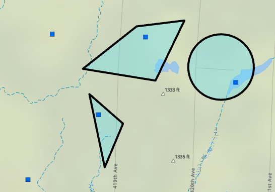

Hello there, so I am going to try to be detailed about my two major questions I have, and hope these aren't so simplistic that I am wasting anyone's time. I am very new to ArcGIS Pro, and my professor suggested that this forum is an amazing resource for specific questions. I have attached a photo of an example of what I am referring to. Questions are as follows:
1. I have mapped out all of my locations I need to, but I need to create polygons around the specific locations, with their size being determined by a preset number of acres. What would be the best path to complete this task? I am able to make polygons by creating them, but I am unsure how best to make the acreage data associate (I do have an ID for the locations, and an ID set for the acreage already) with my locations. I believe this would be done through join, but have failed to make it work through the last several attempts.
2. Once I have associated the acreage to the locations, what would be the best method to make the acreage into a polygon that surrounds the location and expands/shrinks based upon inputted acreage?
Thanks so much for any and all of your help/guidance/advice, I really appreciate it. Have a great day.

So there is the Business Analyst extension to ArcGIS Pro that has a geoprocessing tool (GP tool) called Generate Grids and Hexagons that can create a square, hexagon, or H3 Hexagon that can create polygons of a certain area (i.e. acres for example).  Run the GP tool to create the polygons.  Then it's just a matter of selecting the polygons and moving them over your points layer and deleting the polygons you don't need.  I'm sure there's other ways of doing this.

Thanks for your response. I checked out this tool, and it is really helpful to learn, but unfortunately I would not be able to make a polygon for each individual location, as there are over 9,000 of the points I have to  map out. I am going to check out more about this specific tool to try to figure out if there might be a way to map out them all at once, but thanks again and hope your day is going well.
