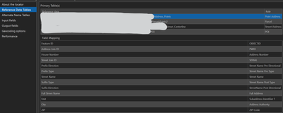

In the past I had a General - Single Field locator that would search on a street name.  I put this in a composite locator with address info.  So if a user came up with a house number that doesn't exist it would at least match on the street name and get them close.  I can't seem to do this in Pro.  I tried using Point Address but it wants another field besides just Street Name.  What can I do to make an address locator that will take them to the street, even if they don't enter an address?

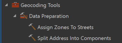

If your addresses are in a single attribute field I would recommend breaking them out into individual fields.
Try using the Split Address Into Components tool

If you build a StreetAddress role locator, it supports returning StreetName, Street Intersection, Street Midblock, and streets in between other streets as well as the Street Address with the house number. https://pro.arcgis.com/en/pro-app/latest/help/data/geocoding/introduction-to-locator-roles.htm#ESRI_...
The PointAddress role locator does not support returning street name matches, which is why you could not build a street name only locator using the PointAddress role. The house number and street name are required for the PointAddress role.
