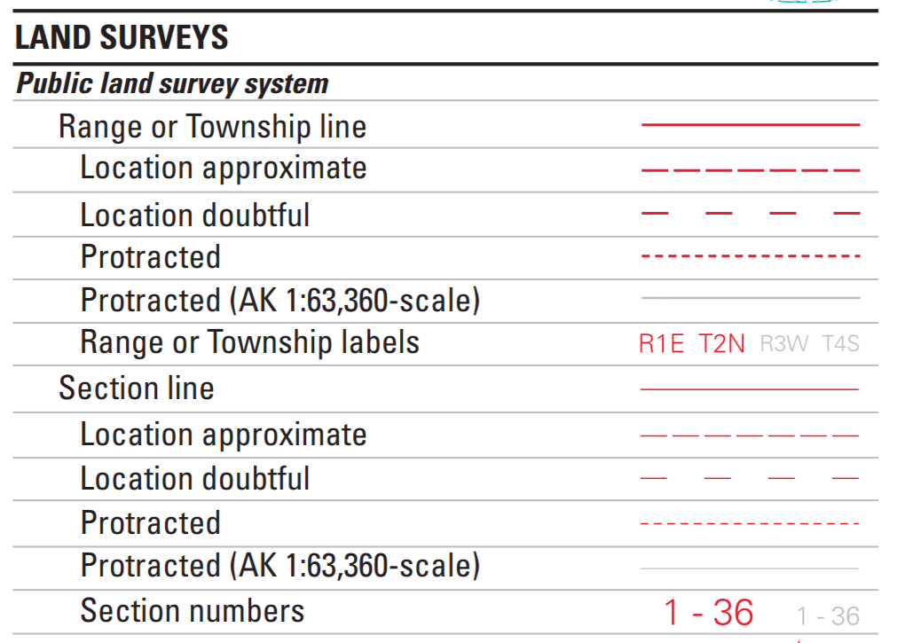

I couldn't find this posted anywhere. Is there a way to obtain the PLSS (Public Land Survey System) line styles and such that the USGS uses? I'm mostly referring to this document of topographic symbols:
https://pubs.usgs.gov/gip/TopographicMapSymbols/topomapsymbols.pdf
Small example:
I mainly want to symbolize the Township and Range lines along with sections, quarter sections, and quarter quarter sections (40 acre lines). In ArcGIS Pro 2.3.1
Tagging Curtis PricePLSS EditingFederal

There might be some goodies for you here. They were developed for ArcMap but you can probably import them to Pro.
New GIS-Ready Topographic Map Style Template Released
AdrianWelsh
MVP Honored Contributor
That is what I was looking for! Well, it's a bit of a clunky work around but I can make it work.
Thanks Curtis!
They even have labels with expressions!
