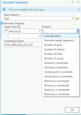

09-19-2021 07:26 PM
jvenables
Can someone please confirm if Esri have in fact removed the capability of calculating planar areas when a feature class is stored geographic coordinates? This was a really useful function in ArcMap (when map is projected) but appears to not be available in ArcPro. You used to be able to chose the map projected coord system OR or the data source coord system.
If not available, is it in development, or have they just removed it?

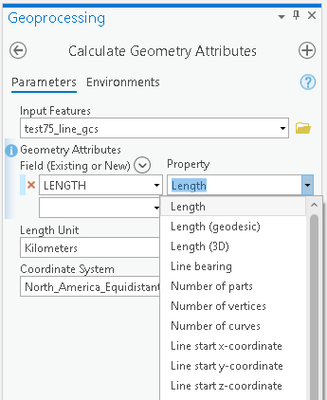

Here is the planar Length property being selected for data in WGS 84, with a North American Equidistant Conic projected Coordinate System:

jvenables
You can specify the coordinates, but the Property field doesn't allow for planar area calcs. Even if you specify the Coord System in the box, it still calculates the geodesic area. So not actually sure what the purpose of the Coord system box is?

jvenables
When I use the measure tool and select 'Planar', I get 28,400.30ha as my result, which is the result I want to add to my attribute table. When I run the area calculation tool, regardless of which coord system I select, it always returns the geodesic area of 28,391.997ha. The data is stored in GCS, so this makes sense, but I'm looking for a function that will calculate the planar area based on the current projected coordinate system of the map. ArcMap can do this with no issue, but it appears ArcGIS Pro is lacking this functionality. What I'm after is essentially a !shape.planarArea@hectares! expression, but that doesn't seem to work.

Thanks for bringing up this equivalency problem @jvenables
In Pro 2.9 this problem has been solved. You will find the planar AREA and LENGTH options (not Geodesic) in the Property choicelist you pictured above, even if your data has a geographic coordinate system, as long as you specify a projected coordinate system in the Coordinate System parameter (you can choose the Current Map option in the Coordinate System choicelist if your map is projected).
