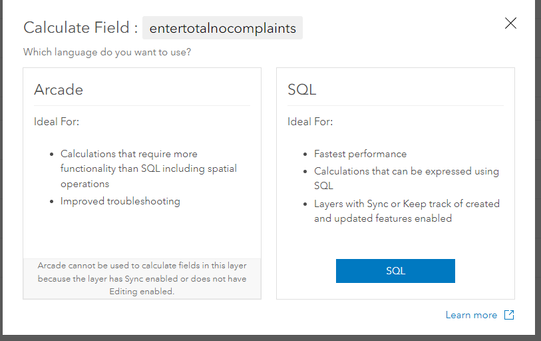

I have to use SQL because I have layers with sync or keep track of created and updated features enabled.
In a nutshell, I created a column titled 'entertotalnocomplaints'.  Note, this is a field map app the deputies are using. As of right now the deputies must count the number of complaints received on one address and then enter the total into this column. I feel I should be able to count the number of complaint fields that have text and return that total count to the field 'entertotalnocomplaints'.  So count those with text and return a numeric number to the 'entertotalnocomplaints' field.

Info - I created a Field Map app for our deputies to use. I have a feature layer with several fields and my thought is to use the calculate field to perform a count on specific columns. Basically counting the field, if there is text, count it as 1, add the counts and enter total count in my "Enter Total Number of Complaints" field.
I am in the Enterprise, go to the layer, go to data, find my field "entertotalnumberofcomplaints", click calculate on that field.  And based on the image below, I must use SQL.  The complaint fields are string and the 'enter total complaint number' field is numeric. Does that help?
