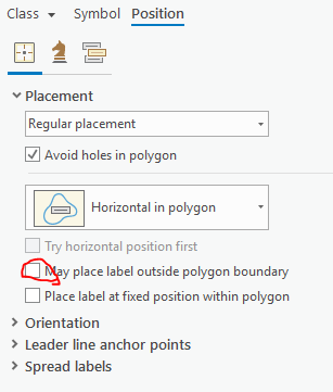

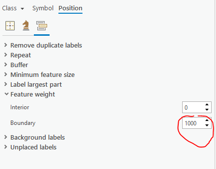

I would like the polygon you see here to NOT have a label, because one cannot fit within it at this scale. This was accomplished in ArcMap with both the maplex engine and the default, but I cannot get it to work with ArcGIS Pro.
I have turned off outside polygon placement and set a boundary weight of 1000. This is not sufficient, apparently, and I don't see a "Only display label if it fits fully within polygon" option. Am I missing something?
