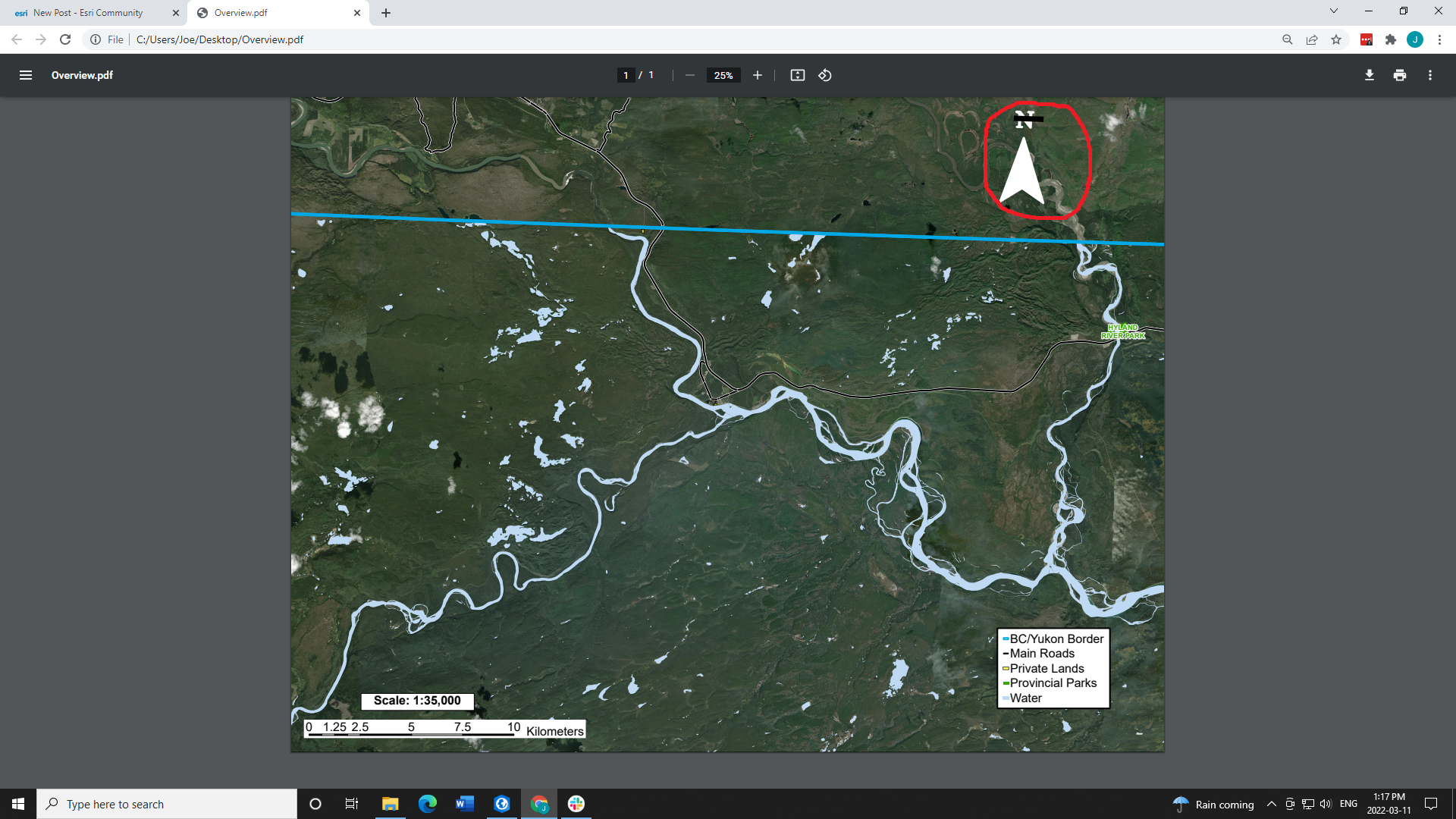

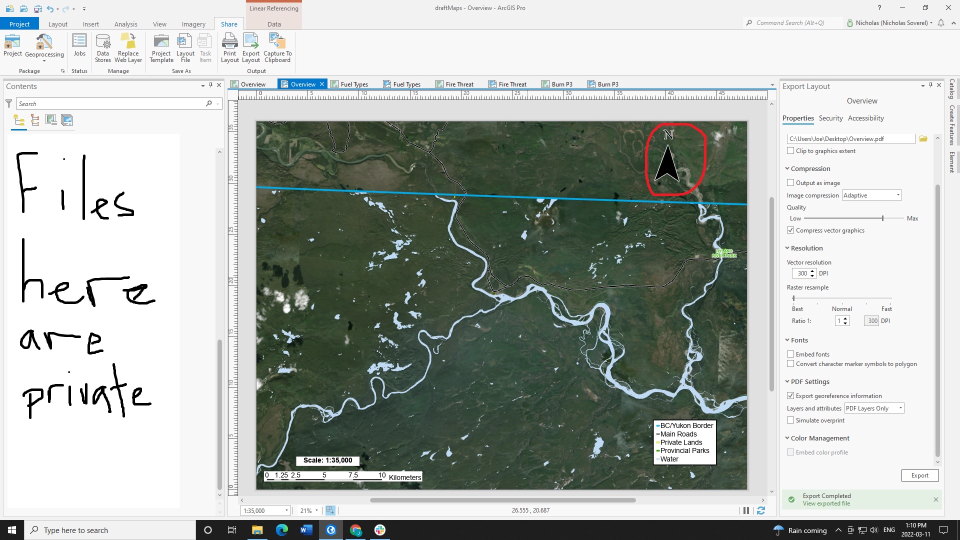

Hello,
I'm using ArcGIS Pro version 2.9.2 and I'm having problems with my north arrows upon exporting maps from a layout view. They don't seem to export as as they appear in the layout view. I have this problem regardless of the north arrow I choose and regardless of the file type to which I export my map. I've attached 2 screenshots below: the first is of how it shows up in Layout View prior to exporting and the second is the exported map. I've manually drawn in the red circles over the screenshot. I appreciate any assistance offered, thanks a lot!

related, Solved: Export to PDF changes north arrow display to two d... - Esri Community
see Jeremey's answer regarding settings to see if they apply

Somehow I missed that thread. Thank you!
