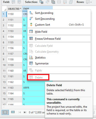

I have a standalone table in an Oracle 18c XE database that is not an enterprise geodatabase.

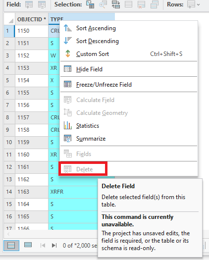

I want to delete a field from the table using attribute table functionality. But when I right-click on a field in the attribute table, the Delete option is greyed out.
The hover-over text says:
This command is currently unavailable.
The project has unsaved edits, the field is required, or the table or its schema is read only.
I don't think any of those statements apply to this scenario.
Meanwhile, I am able to delete the field from the Catalog —> Fields view without issue.

Is that a known issue?
Shouldn't I be able to delete a field from the attribute table, just like I can do with a table from an enterprise geodatabase table (and when using the Catalog —> Fields view)?

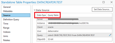

When you add your Database Table (ie not from an Enterprise Geodatabase) into Pro, it is added as a Query Table (see Properties) into the map's Table of Contents, hence you cannot edit it's structure.
But in Catalog it is a Database Table, so you can edit it.
With an Enterprise Geodatabase both of these are type Enterprise Geodatabase Table, so you can edit in the Table of Contents and Catalog.
