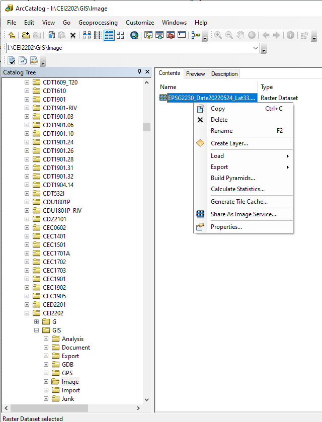

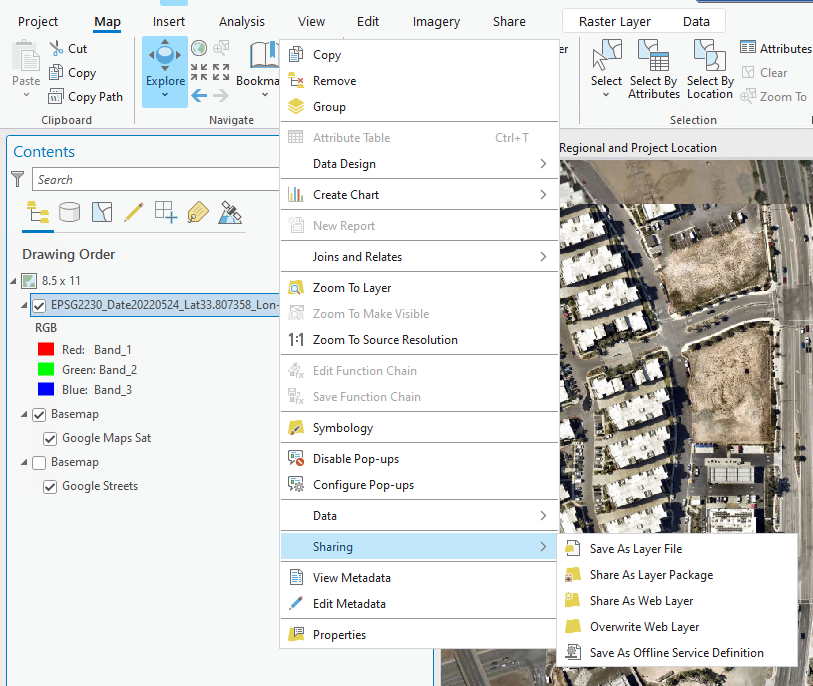

In ArcGIS Pro 3.0, when I right click on a georeferenced jpeg image in the Catalog pane or in the TOC, I only see the "Share as Web Layer" option, while in standalone ArcCatalog, right-clicking on the same file yields a "Share as Image Service" option.
In ArcCatalog:
In Pro:

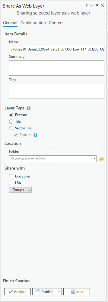

I thought maybe it was just a terminology difference, but no... if I select "Share as Web Layer," I only get the vector options:
Does anyone know why I'm not seeing the option to publish an image service in Pro? Thanks in advance!

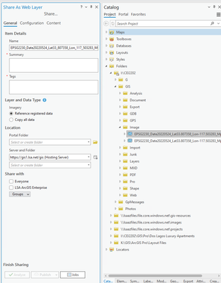

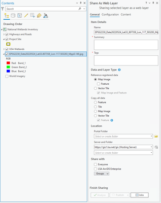

Upon further digging, I have a follow-up question. I get a different Share as Web Layer pane for the same image depending on whether I select the option by right clicking on the layer in a map's table of contents or if I select the option by right clicking on the same file in the Catalog pane. Here are the results of both actions:
This is the result of right-clicking on a raster image in the TOC and selecting Sharing > Share as Web Layer:
And this is the result of right-clicking on the same layer in the Catalog Pane and selecting Share as Web Layer:
The latter results in successfully publishing the layer to Enterprise, while the former publishes a layer, but unsurprisingly it's not a raster layer and won't draw.
