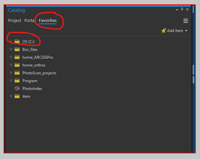

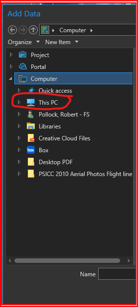

Has anyone in here have a luck adding Favorites to the "Add Data" to get access to your hard drive aka C drive ?
Here is a example of what I am talking about :

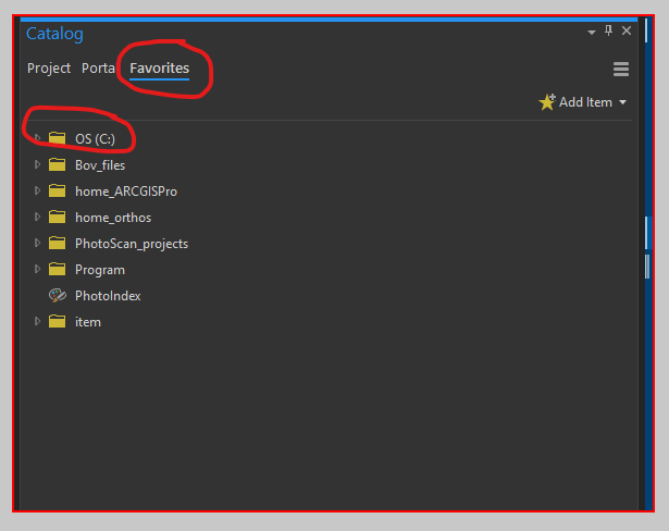

But when you open Catalog Pane, it is there for you to access to OS(C:) hard drive ?
Is there a way around to add the Favorites like the one in Catalog Pan in the dialog box for the Add Data ??
wayfaringrob
Honored Contributor
Unfortunately, no. This frustrates me on a daily basis - having to manually head down lengthy directories every time I want to add something. Add your support here: https://community.esri.com/t5/arcgis-pro-ideas/add-data-favorites/idi-p/966435

Instead of using the Add Data pane, I just use the favorites.
Expand the C: drive in my favorites, navigate to the dataset, right-click and say add to current map.
This way, it is always there and I don't have to add it/navigate to it every time.
Can also right-click on the c: drive in favorites, and select Add to Project.
Then, it is available in the Add Data pane under folders.
