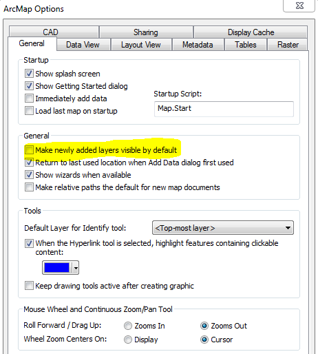

Does anyone know how to change this setting in ArcGIS Pro? In arcmap, we can go to the ArcMap options and turn it off so that when you add large datasets it wont be visible by default. Is this option available in Pro?

Found the answer!
On the Edit tab, in the Manage Edits group, in the lower right corner, click the Dialog Box Launcher Launcher.
The Options dialog box opens.
Click on Map and scene
