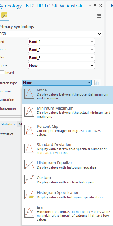

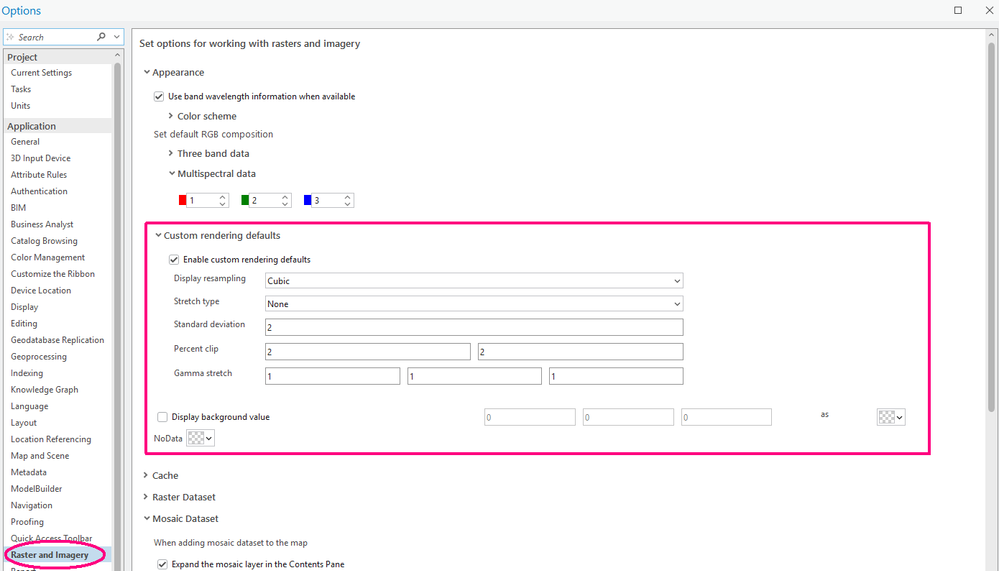

That aside and if you don't want to change your workflow, have a look at the rendering settings applied to new images loaded into a map.
Pro seems to sometimes do weird things with the imagery symbology & rendering settings. Check your settings/options and set it to what you want.

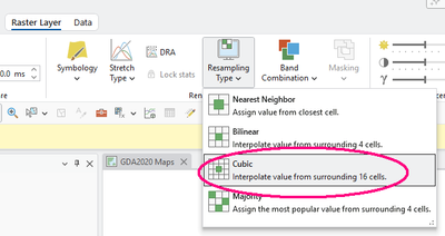

Compare what you have for the tiffs vs mosaic in the layer symbology when you have it loaded. It may just be an auto gamma & resampling method difference:
then look at the resampling method used. I prefer to have Cubic on unless I want to see pixels.
I think by default Nearest Neighbour is used.
