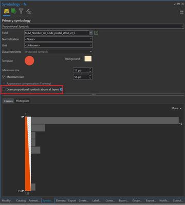

Maybe I have an idea of the problem... On my map, I have proportional circles that I made from a surface layer.
So, it's the same behavior as for labels (still on top of the map). There is therefore a conflict with the annotations made from the labels : the circles will always be displayed on top...

Olivier_B
Hello Zazie,
Dans la symbologie de ta couche proportionnelle, décoche "Dessins proportionnel toujours au dessus des autres couches". J'ai mis quelques heures à trouver ce paramétrage.
In symbology tab of your proportionnal layer, uncheck "Draw proportionnal symbols above all layers".
