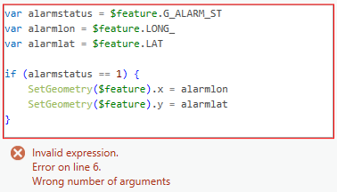

I want to move the existing points to the lat/long in the attribute table when it updated. I'm thinking using the Attribute Rules, but I don't know how to write the expression.
This is where I am
I'm not sure 'SetGeometry' is the right function or not...

The post here describes a Calculation Rule
from - Solved: Can Arcade be used to UPDATE a feature's geometry? - Esri Community
Edit the geometry of a feature with a calculation rule.  Attribute rule script expression examples—ArcGIS Pro | Documentation

Oh so I can't modify feature using Attribute rules. That's sad...

haha you can, if you go to the last post in that thread it then links to the Calculation Atrribute rule (also linked in my post)
