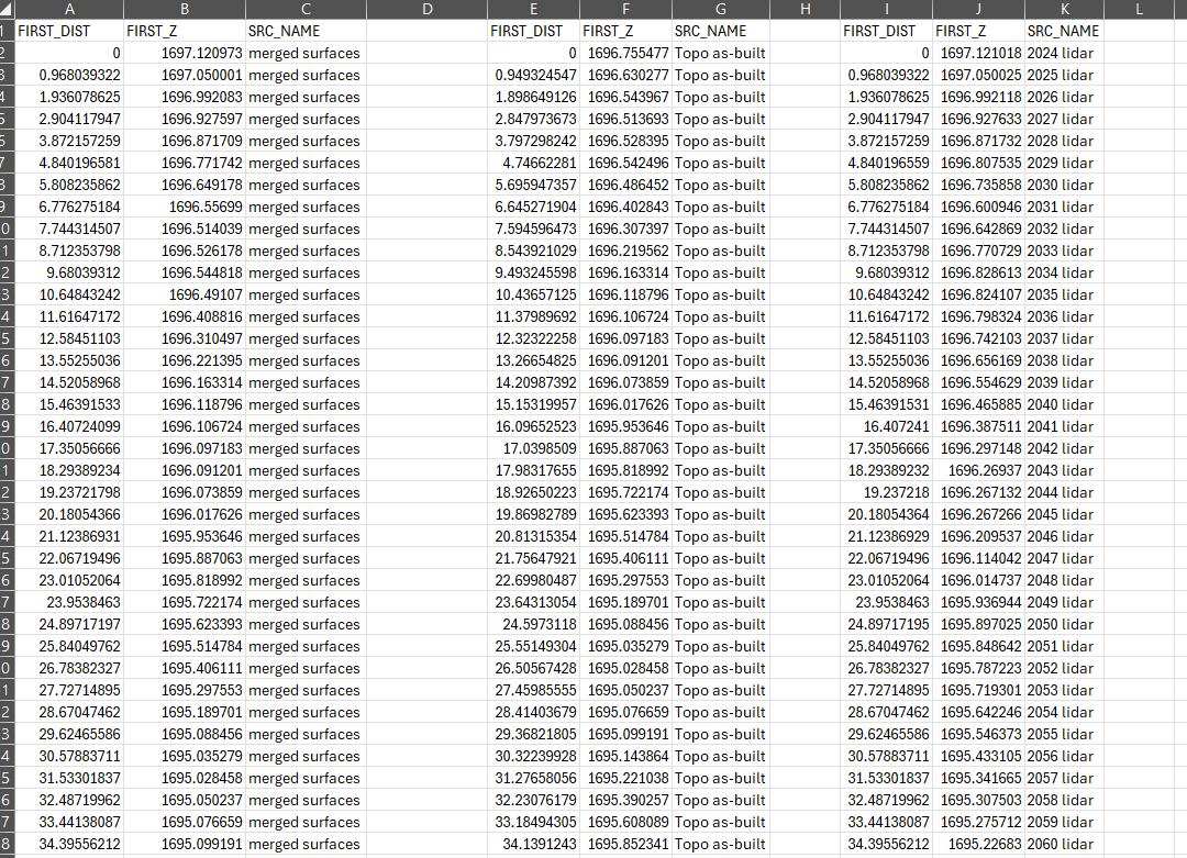

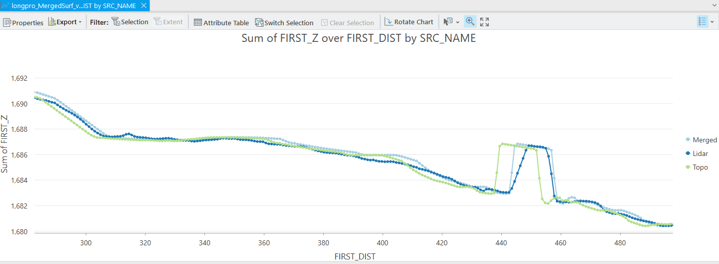

I have been plotting an elevation profile along a line to QA/QC this, using the Stack Profile tool and inputting all three surfaces (lidar-derived surface, topo-derived surface, and the merged surface). Please see photo below. I plotted it using the Create Chart tool in Arc, but also exported to excel to make sure it isn't a plotting error - they are the same.
 I did notice that the "x" sampling distance is slightly different between the three surfaces (about 0.1 ft off) - does this indicate the surface pixels are not aligned? What could be causing this issue, and how can I merge these two surfaces to produce an accurate product?
