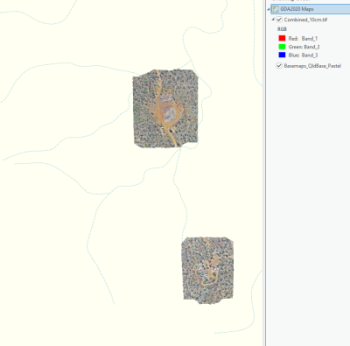

My goal is to create a mosaic dataset in ArcGIS Pro to be published as a WMTS (Web Map Tile Service) on AGOL. Defaults were used unless otherwise stated below.
Workflow:
Prep Step (Delete any *.OVR files from the folder where the Geo Tiffs are stored)
I created a new project called "Imagery" and used the default as my gdb
I created a Mosaic Dataset (natural color, 8 bit unsigned)
I added raster (Processing template :stretch, raster type: raster dataset, input data: folder)
I built footprints (radiometry, min =1 max =254, unchecked skip overviews and kept update boundaries unchecked)
I built seamlines (comp method= edge detection, checked update existing seamlines, sort method northwest,  sort ascending checked)
Define Overviews (force overview tiles checked, number of levels = -1, resampling method nearest neighbor, quality= jpg 80
Build Overviews (unchecked define missing overview files)
From Here I want to publish it as a tile service but I need the white area problem fixed first.
* since my footprints were 1-254 this should drop out 0 for white, 255 for black and 256 for no value, right?
Everything I read said not to clip the raster mosaic dataset but to use building footprints tool but I have and I can't get rid of the band. It appears to be the portion of the *.tiff that has been removed by the supplier of the aerial imagery. I am currently running a clip raster (my mosaic data set as the input raster and a 200 ft buffer around my county boundary as the output extent. But I would love to know how to update my workflow to prevent this from being created so I don't have to clip it. I had the same problem with my imagery last year but went ahead and published it out as a WMTS anyway. I really want it clean this year, as I need it to display with neighboring imagery and this white area creates a problem. I have also included a link to last years WMTS, that has the same problem. (https://tiles.arcgis.com/tiles/G4bYaaas92zuKaUR/arcgis/rest/services/BentWashImg2024Pack/MapServer)

Hi Stephanie
The easiest by far for future data is to set a requirement that your supplier delivers a 4band image with transparency set for any no-data areas.
Most good ones do by default, unless an old contract specifically told them not to 🤣
If your current Tiffs have compression then the 'white' band will likely have artefacts so when you set a single value as no-data you may still be left with blotches of Lexington (a shade of white. renovating, sorry).
Editing footprints being preferred is valid - but can be quite fiddly for complex areas.
Create a few boundaries/extents that you can use to either clip imagery dynamically or to clip the mosaic footprints against.
This means you'll have consistency across datasets.
