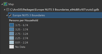

If you're re-downloading the file, it shouldn't retain any changes that you have made.
However, note that when you open that package, it is copying a geodatabase to your ArcGIS/Packages folder (you should see a brief loading bar that says "unpacking"). I wonder if the layer package sees that it already exists on your machine and doesn't re-copy it on future attempts.
I tested what you describe, and my merged features persist as well. I would go into your Packages folder, delete the GDB, then re-open the layer package, and it should create a fresh copy with no changes.
