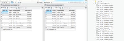

I would like to merge over 100 layers into a single layer, and use the layer name from each layer as a new field name with the attributes pulled across.
For example the final table might look something like this
Does anyone know how to do this?

I believe the Merge (Data Management) GP tool using the Field Map parameter to add fields to the output attribute table would be your best approach.
