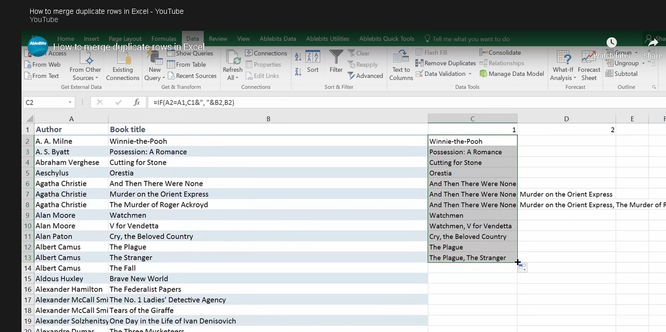

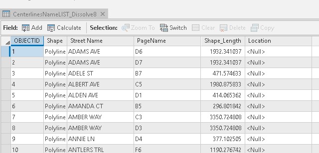

I have this issue with similar to the above attachment. Multiple duplicate attributes in column A but different attributes in column B. I want to combine the duplicates of "A" in one row while retaining and merging all of the attributes in Column B. Is there a tool for this? Or can someone translate the Excel formula into a python script?Pro Data

Thank you for stating your licensing level, it is helpful for GeoNet users to know.  Are you wanting a new table with only the two columns?  If not, how do you want to handle the geometry and other fields when collapsing the table?
