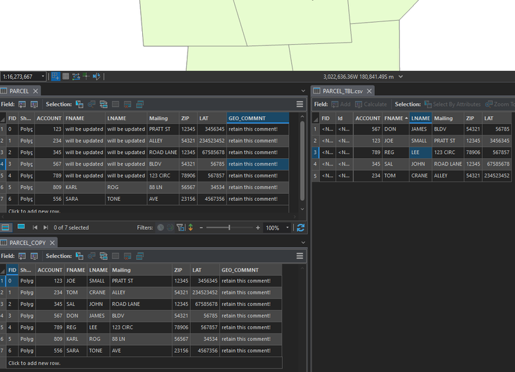

Using Join and Field Calculator works, but would be far too tedious and error prone in my opinion, but that might depend on your jurisdiction's parcel dataset complexity. I would use Python and Search/Update Cursors. More flexible long-term, and avoids having to manually use Field Calculator on a ton of fields.
Let's assume "ACCOUNT" is the common field name between the Geometry shapefile and the attribute update table. "PARCEL" is the original geometry table, "PARCEL_TBL" is the published CSV of tabular updates, and "PARCEL_COPY" is the updated version. Note that only the intended rows are modified, and any geometry-specific fields can be left alone during the update.
This will not ADD new records--you'd have to write that into the code, or first manually draw in the geometry with an ACCOUNT ID into the geometry shapefile.
This script reads through the update table and makes updates where appropriate in a COPY of the geometry table.

# Read the update table. Use the ACCOUNT ID as a dictionary key.
with arcpy.da.SearchCursor(table, [account_fld] + common_flds) as scurs:
    fc_dict = {row[0]:row[1:] for row in scurs}
# Make a copy of the original Geometry shapefile.
# This could be modified so that the existing is archived as a backup, and then
#   the current is updated.
poly_copy = f"{polygon.split('.')[0]}_COPY.shp"
# If the Account in the Geom shapefile requires updates (based on ACCOUNT ID),
#   update the row.
arcpy.management.CopyFeatures(polygon, poly_copy)
with arcpy.da.UpdateCursor(poly_copy, [account_fld] + common_flds) as ucurs:
    for acct, *row in ucurs:
        if acct in fc_dict.keys():
            print(f"OLD ROW: {[acct, *row]}")
            ucurs.updateRow([acct, *fc_dict[acct]])
            print(f"UPD ROW: {[acct, *fc_dict[acct]]}\n")
