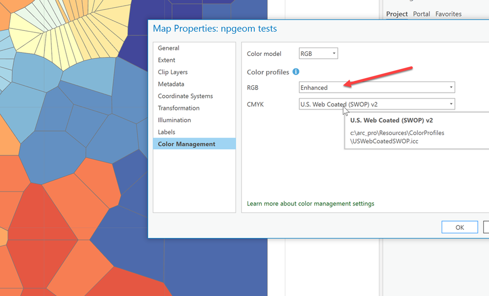

Project backstage, Options, Color Management.... do you have anything specified? does changing anything change the appearance on the map?
... sort of retired...
JamesCliver
Not really... (see attached).
Thank you for responding!
DanPatterson
MVP Esteemed Contributor
Well I set it in the project section, then when you right0click on a map's name in the TOC, and select properties... You can change stuff.  My eyes are too old to make a qualitative or quantitive assessment, but you might want to give it try.  Otherwise you will have to wait for someone that does the cartography stuff more than I do

JamesCliver
Yes!!! That was the culprit! THANK YOU!!
Attaching a screenshot of the setting that needed to be changed in case it will one day help others. Turning down that transparency number from 45% (which was the default value) to 0% solved my problem. Thank you again!!
