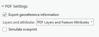

Have you switched off these settings?
to this:
tvmangum
I already had those options turned off.
