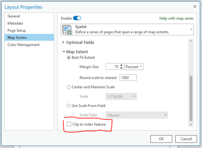

Thank you for the reply. I noticed that when in Map Series I have the Best Fit, Center and Maintain and Use Scale from Fields but I never get access to the Clip to Index Feature checkbox.
Any thoughts on that?
Thanks again!
GR
AubriOtis
Odd, the checkbox should be there below the radio buttons. What version of Pro are you using? Maybe it's an older version before this feature was added?
Cheers,
Aubri
GRmapper

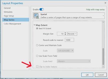

I check box is grayed out and unavailable. Hmm.
AubriOtis
Is your index feature a point layer?
Cheers,
Aubri
GRmapper
No.  They are lines.
AubriOtis
Ah, that's why. You can't clip a map to a linear feature. You'll need to use a page query in this instance.
Cheers,
Aubri
GRmapper
I'll give that a go. Thank you again.
