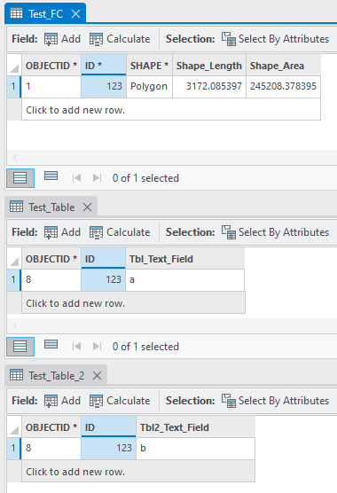

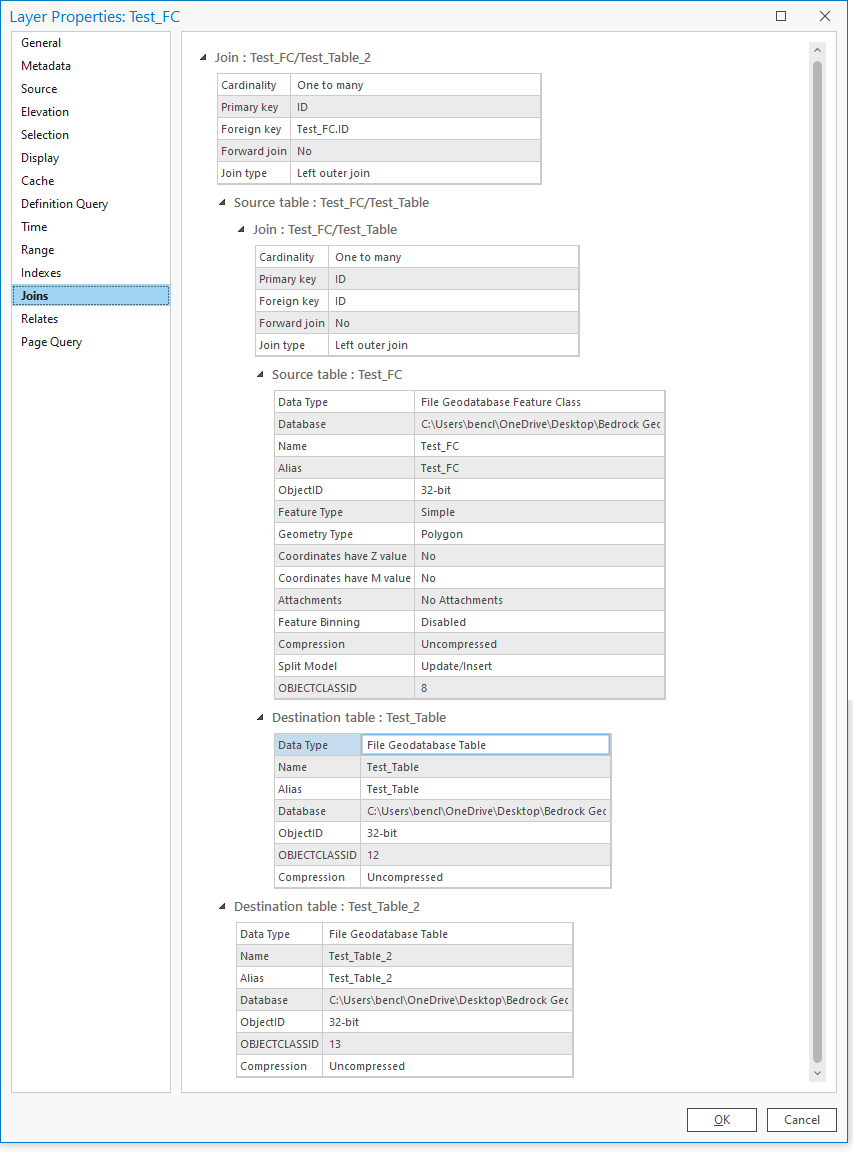

I have a FC and two tables:

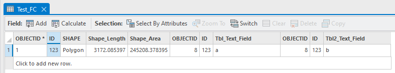

I've joined from Test_FC to Test_Table via the ID fields.

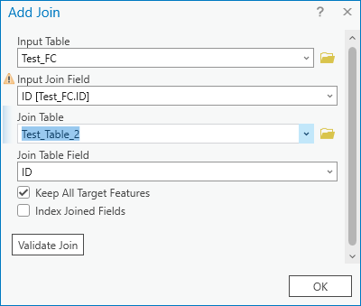

I've also joined from Test_FC to Test_Table_2 via the ID fields.
Result:
Question:

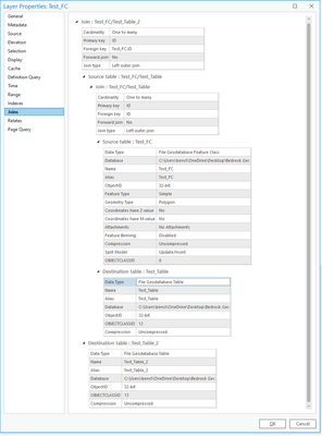

This is what the Layer Properties >> Joins window looks like:
To be honest, I don't really know what I'm looking at in that diagram. The structure presented there isn't what I expected to see; I would have expected something like this (but more elaborate):
  • Test_FC
    • Test_Table
    • Test_Table_2
Is that diagram presenting the joins correctly?
Thanks.
ArcGIS Pro 3.0.2
Bud
Esteemed Contributor
For my notes, Esri Canada support said this (case 03209739):
"Based on your workflow, the diagram does appear to be presenting correctly and I will try to break it down below:

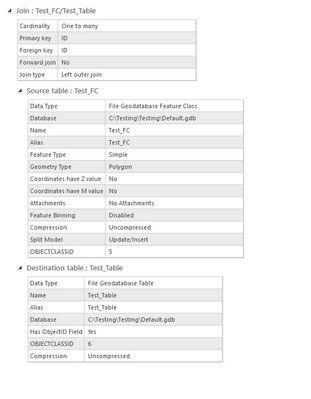

  • In the diagram, each join performed has the Join information with the Source and Destination table. The source table would be your input table (Test_FC) and the destination table would be your join table (Test_Table) .
  • In the case of your first join, the diagram would look similar to this:

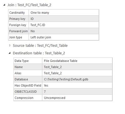

  • When the second join is added, the source table is the previously joined table above (Test_FC/Test_Table) and the destination table is Test_Table_2:
  • Expanding the source table here would display the first join details (first image above)
