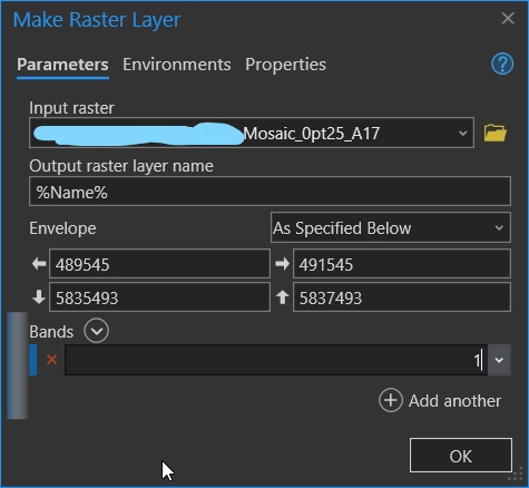

Hi All,
another MakeRasterLayer question:
For the layername I am using %Name%
the names of the layers look like:
%Name%:<the name of my layer>
for example
%Name%:RasterName1
%Name%:RasterName2
For some reason the Layer names are adding a non-interpreted value %Name% and the Colon..in front of each layer with the MakeRasterLayer in ModelBuilder.

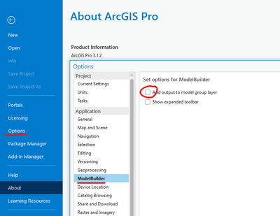

I've been complaining about this very issue, it was functionality that was introduced into ArcPro in version 2.9 I think. It breaks all sort of model logic. So in response to this ESRI have not accepted it was a bad idea, get rid of it, they just put in an option to turn it off /on. I have it turned off!
Go to application options > Modelbuilder tab > and turn it off!

Gordon_Aberdeen
Brilliant! Thanks for fix!
