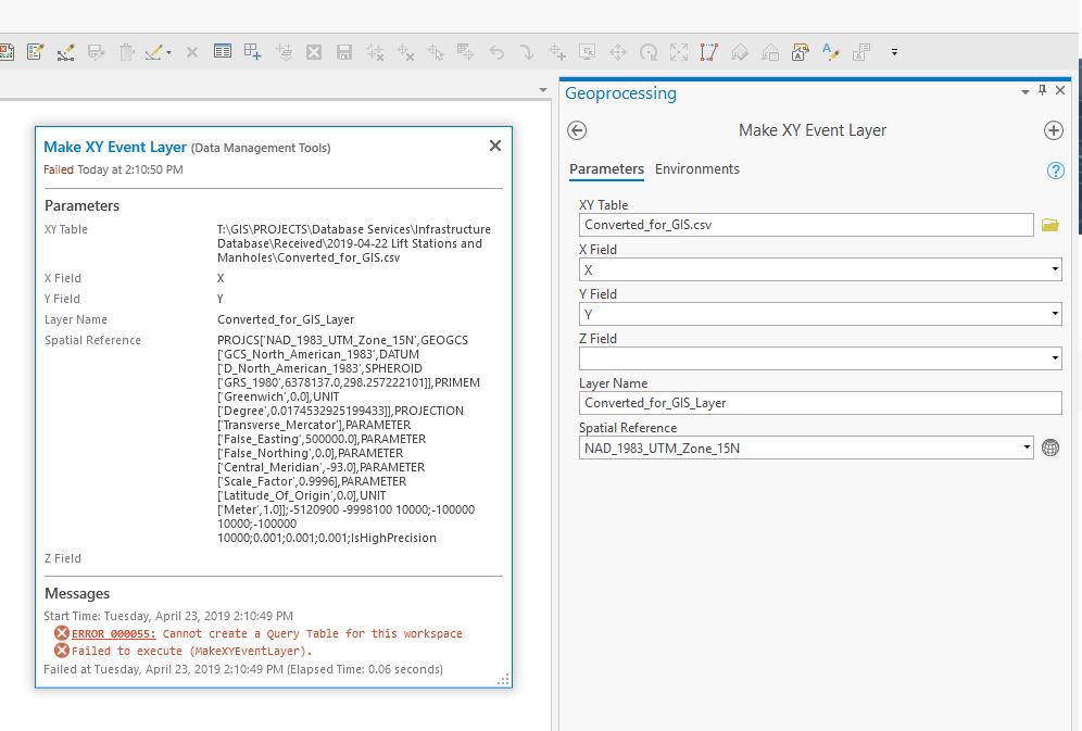

When I create an XY event layer in ArcMap from an .xlsx sheet it automatically reads X and Y fields OR I am allowed to choose those from a dropdown menu.  PRO does not read XY fields from .xlsx  nor does it read the field names into a similar drop down menu. This small difference makes importing XY data into Pro very cumbersome.  When I re-save the spreadsheet as a CSV file, PRO will read the field names and pre-populate X and Y fields but then it fails on execute with:  ERROR 000055: Cannot create a Query Table for this workspace Failed to execute (MakeXYEventLayer).

EDIT: As Kory pointed out the issue with reading field names from an Excel file is an existing bug. I was able to successfully create an XY event layer after reviewing the source data and again and ensuring all values in X and Y columns were numeric.

Thanks for the response. I subsribed to watch the bug status.
Also, I just tried saving the .xlsx as CSV and running Make XY Event Layer again and it succeeded but I further cleaned up data and ensured data in X and Y columns were in fact numeric and valid.
