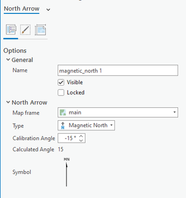

So the more I look into this, it seems like the auto-calculate is no longer working (i.e. BUG).  I did search the internals for an existing BUG report but they're old going back to 2.6 days.  For your MN north arrowhead, if you select it, go the North Arrow->Design contextual tab and type in -15.03 for the calibration angle.  Does your north arrow and dynamic text then update correctly?
ZacharyUhlmann1
Hi @Robert_LeClair your solution does work, however not positive I followed your protocol?  Specifically I'm unfamiliar with the terminology "Contextual Tab", but I think that's what I did.
NOTE: the North Arrow assembly I'm displaying is a group of elements; the off-axis arrow pointing ~15 deg with "MN" on the top is the element of interest.
The dynamic text (Magnetic North) does NOT update with the manual input of degrees however.

I'm glad the manual approach worked for you.  Yes, contextual tab.  When you click on a North Arrow element in the layout, 2 "temporary" tabs at the top of the ArcGIS Pro application open.  These particular tabs are for the North Arrow element selected and they're called contextual tabs.  This means when you click on something, temporary tabs for that item open.  Hope this helps!
With regards to the dynamic text NOT updating.  I too was seeing this and believe it to be a BUG.  I recommend reaching out to Esri Support Services to work with an analyst and log the BUG.
Lastly - thank you for describing your workflow creating this north arrow.  I thought it may be a group of elements stacked on top of one another as I created the same north arrow configuration to test the workflows.
