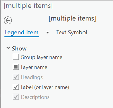

I have a ArcGIS Pro 2.5 map in which legend items (group layer name, layer name, etc.) are locked. They are checked but grayed out. See attached snips.
I have tried deleting the legend and creating a new one. I have tried creating a new layout. I have tried removing layers and re-importing them from the database. I have re-started the application. None of these has solved the issue.

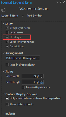

I'm seeing this in version 2.8.2:
Mine's greying out the Headings checkbox. Single legend item, legend isn't locked, and I tried removing the layer from my legend and readding it - same result. Restarted Pro, nothing. I could try a new project file, but it's not an old project; I created this project last week.
Any feedback on this would be greatly appreciated. This is the first time I've seen this, and I'm a daily Pro user.
Patrick_G
Deleting the Heading text worked, but that's goofy. Especially if I change my mind later and want to format that text and show it.

I am having this exact same issue with legend items being checked and greyed out. I specifically need to turn off the Heading. I am working with a raster layer, which could possibly be the reason, but I haven't found any documentation that states rasters would cause the greyed check box. I am unable to find a solution in all of the documentation and community answers I've read; did you eventually find a solution?

Hi Jeremy,
I'm sorry you are having trouble getting your legend exported correctly. Your issue sounds a bit different than the one initially described. Options like header and group layer name for legend are designed to be greyed out (disabled) when they aren't applicable to the layer type. So if the layer isn't in a group you won't be able to interact with group layer name, if the layer symbology doesn't support headings then heading will be disabled.
From your description it sounds like you are experience a difference between what is drawing on the layout, and what is appearing in an export. This sounds like an export bug. Since 2.8.8 we have fixed several reported export bugs in the software, and done work to make exports faster and more robust. It's possible upgrading might fix your problem.
If it doesn't, or if that is not an option currently, I recommend reaching out to technical support to log a bug. They can make sure it gets seen by the right team, and help you figure out if upgrading might resolve your issue. You can reach them here https://support.esri.com/en-us/overview
