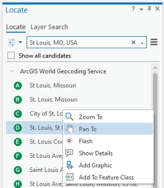

Does your Locate Pane look like this?  When I go through the list right-clicking on each and choosing Zoom To, the scale is different for each, sometimes zooming in, sometimes zooming out.  If I right-click and choose Pan To, the scale doesn't change.

Could you try Pan To instead of Zoom To, so the zoom level stays the same?

BryndaHatch
ScottFraser_Key-West
Cool!  I wasn't even aware there was a right-click option with the results list.
Thanks Brynda
