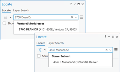

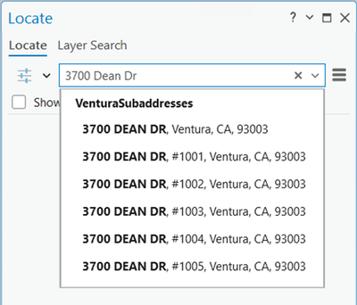

We've added the ability to return a list of subaddresses and a summary of  subaddresses at an address after typing the base address to ArcGIS Pro 3.0. A feature that represents the base address is required in the reference data used to build the locator in order for the new functionality to work. A locator with the new settings enabled must be created in ArcGIS Pro 3.0 and published to ArcGIS Enterprise 11.0 . The new properties, " Show summary of subaddresses with base address suggestion" and "Suggest when base address is typed" are disabled by default and the number of suggestions displayed can be configured in the Locator Properties dialog on the Performance page. If you are part of the Early Adopter Community or have access to ArcGIS Pro 3.0 Beta1  you can test out the functionality and provide any feedback. If you were to go through the create a multirole locator tutorial , you could test the new functionality with the following addresses:
- 1508 CIRCA DEL LAGO, SAN MARCOS, CA
- 1616 CIRCA DEL LAGO, SAN MARCOS, CA
