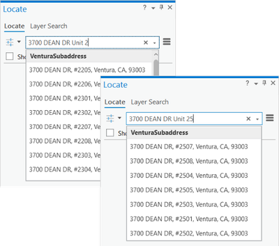

We've added an option to allow subaddress suggestions before the entire unit value has been entered.  Typing in the unit type, such as Apt, Unit, Suite, # is also optional. The locator will need to be created in Pro 2.9 and published to ArcGIS Enterprise 10.9.1. This new option, Suggestions for partial subaddresses, is disabled by default but can be enabled, as well as configure the number of suggestions returned, in the Locator Properties Dialog. If you are part of the Early Adopter Community or have access to ArcGIS Pro 2.9 Beta1  you can test out the functionality and provide any feedback.

I tested the "suggestions for partial subadresses" option in Pro 2.9 beta. It works exactly as its name implies. It is definitely an improvement, but also not quite what I anticipated. You must enter some part of the unit number in order to get a suggestion with a unit number. That means you can enter the full base address for an apartment building (e.g. "123 Main St"), but you still won't see any subaddress suggestions until you enter the first character of a unit number. In my ideal world, if I entered "123 Main" into the search, I would like to see a list of suggestions like the below. As is, I only see the first suggestion on the list.
  • 123 Main St
  • 123 Main St Unit 1A
  • 123 Main St Unit 1B
  • 123 Main St Unit 2A
  • 123 Main St Unit 2B
