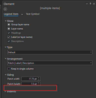

Not sure if you resolved this or not, but I just ran into this same issue in 3.2.1. I just wanted to share what I found. For some reason, "Feature Display Options" only appear for certain types of data that are symbolized a certain way. For example, I had some data symbolized as Proportional Symbols in my map, and for that symbology type "Feature Display Options" would not appear under the legend item.  When I selected points that were symbolized with Unique Values the "Feature Display Options" would appear. The resulting limitation (that #Esri needs to figure out) is that if you have all of your legend items selected, and the "Feature Display Options" are not available for one of them, then the "Feature Display Options" don't show up at all. This appears to also be true for other dynamic options they have added to the Legend items.

If you select options one by one in the Legend layout item, you will be able to see which layers do not permit showing features visible in the map extent only. In the project I am working on, all feature layers work, however Vector Tile Service and WMS Service layers do not, which makes sense.
