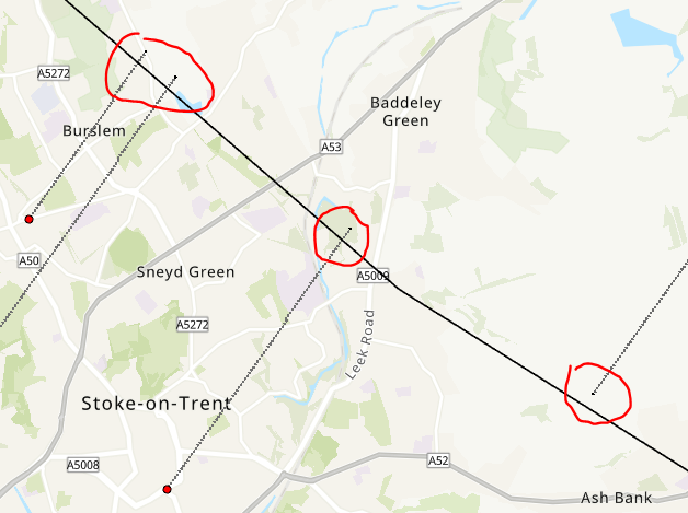

Hello All,
I ran a least cost path analysis from points to polylines in Pro.  At first it looked great, but when I zoomed in, all of the resulting paths either overshoot or undershoot the line features.  Overshooting is fine, but they need to at least touch the target lines.  Any ideas what could cause this?  (the paths also seem awfully straight, but other paths did have some variation, so maybe it's just because England is pretty flat?  I used a slope raster from Copernicus as my cost raster.)

AmyNewsam
Update - I realized the two feature classes were in different coord systems, so I put them in the same and reran LCP.  This time they paths looked much, much better, although still just a hair off of the lines.  I'm going to need these lines to touch, as I'll be using them for route analysis later.  Perhaps there's a way to fill in those gaps?  Or maybe there's a gap tolerance setting in route analysis... but still seems like there shouldn't be any gap.

Hi Amy:
Which tools are you using for your least cost path generation?
If you're using DistanceAccumulation/OptimalPathAsLine (or the legacy versions CostDistance/CostPathAsPolyline), then your source features for DistanceAccumulation/CostDistance, which i think are the polylines in your case, are going to get rasterized first. The second step, path generation, will end at cell centers instead of precisely on the source lines.
You can mitigate this somewhat by using a smaller cell size for the analysis. You might also try post-processing with the extend line and trim line tools.

AmyNewsam
Hi Jim,
OK, I didn't realize the polylines were transformed to rasters during the process.  That makes sense.  I'm using the legacy tools, but I will look into the newer versions.  But I think the extend line option might be just fine.  Thanks so much for your help!
