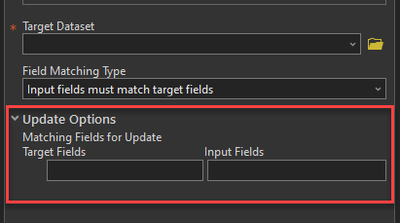

If there is a common attribute between the two layers, you could execute the Append using these fields for the Update Options:
This will update existing records, and create new records.  Therefore, it will not affect the existing GlobalIDs.  However, one thing this will not do is delete features from the Portal layer that have been deleted from the source.  Additional analysis would need to be done for this.
