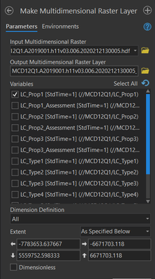

KateEkhator74
Hello,
Thanks for responding. I have tried using the make multidimensional raster layer tool, I still can't make the selection. It comes out with just one option and I would like to select LC_Type1. I have attached a screenshot.
JayantaPoddar
MVP Alum
Don't add the data to ArcGIS Pro first.  For Input Multidimensional Raster, browse to the HDR file location and add the file. Then you can see all the variables.
If you add it to ArcGIS Pro first, only the first variable gets added.
Think Location
KateEkhator74
Thanks this worked.
