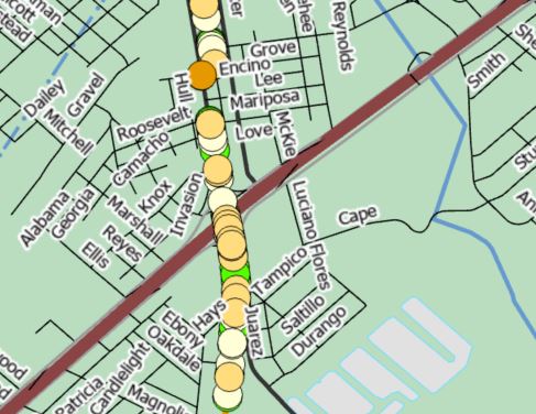

I have created several class labels in a layer and one of the class labels are overlapping features in another layer even after setting the priority and weight.  How to fix this issue?

Kernel Density GP tool is only available with Spatial Analyst and I don't have the extension. But, Please see below, I labeling are on top of the points even when it is displayed as points and not heat map.  Thank you for your quick response.
RadhikaParuchuri
Yes, it is the heat map generated through symbology.  But it is doing the same with the point data displayed as points.  See attached.

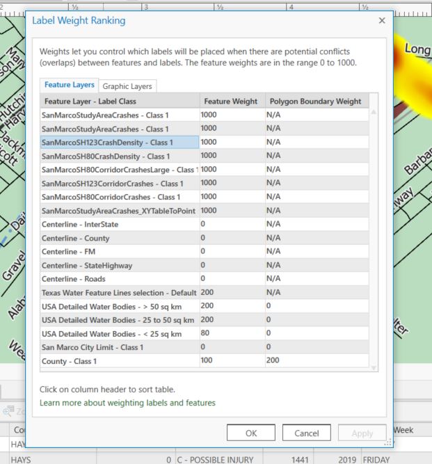

WendyHarrison
Hi
Could you share a screenshot of the Weights dialog so we can see how it's set?
thanks
wendy
RadhikaParuchuri
WendyHarrison
And the point layers are those ones marked 1000?
are the streets by any chance marked never remove?  you can see by going to the conflict resolution tab on the label class pane
