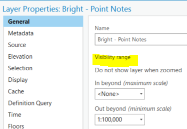

If the pages in the map series have different scales and there are visibility ranges defined on either the layers or the label classes, that could explain labels appearing on some maps but not others.
Layer visibility range:
Label Class visibility range:

It was the set scale the labels were set to appear at. Thanks for the replies
