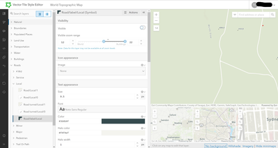

I doubt that you'd be able to edit the data, however, you can try asking about it in the comments on the the World Topographic Map Content Page In the meantime, try using the  Vector Tile style editor to toggle visibility for specific layers in the map, for example Road/label/Local (Symbol). After you edit to your needs, you can save it to your organization and add it to your webmaps as a Basemap.

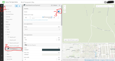

Thank you so much!  This "Vector Tile style editor" is a great place for me to start.  Could you please provide more information about the label ?  I can find different layers there but don't know how to toggle the labels for a specific layer. Thank you so much for your help.

1. Click the Edit Style icon
2. Browse Layers to find the ones you want to adjust (Hint: The icon has a "T" in the corner of it to designate labels)
3. Toggle the Visibility setting
TonyContreras_Frisco_TX_0-1671143968926.pngTonyContreras_Frisco_TX_1-1671144068760.png

Thank you so much.  This is great!  So there is no way to change the content of these labels (but only on and off) ?  Thanks.

It is my understanding that ESRI and their data partners control the content of the services, but you can adjust the styling.
