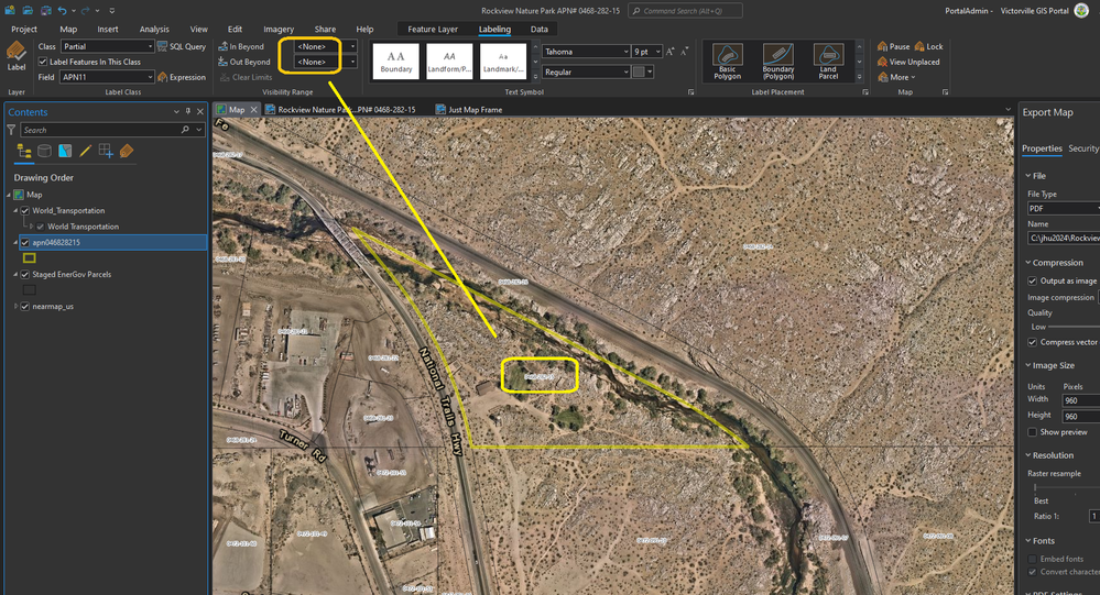

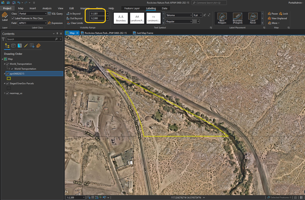

joe_hu_victorville_ca
I figure out why I don't see label is because of this in beyond and out beyond has a setting limit label.
After I set both to NONE, then label appeared.
