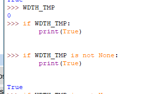

 @RhettZufelt , I did run into an issue though.  As I mentioned before, the WIDTH can actually be a string in some cases or numeric in other cases.
  So right now this code works if the WIDTH is a String, but it fails if it's numeric and WIDTH=0.  So I've tried to add in just a 0 into the code, but it doesn't seem to ignore that.  I've also tried to use the None as well without success.

Apperantly, python evaluates a zero as emtpy, but not None/Null.
the If WDTH_TMP:  comparison will evaluate to false if NAME1 is numeric and = 0 so is bailing out before the next comparison.
If you change it to 'is not None', it shouldn't have this issue:
    if NAME1 is not None::                                        # checks to see if value or Null

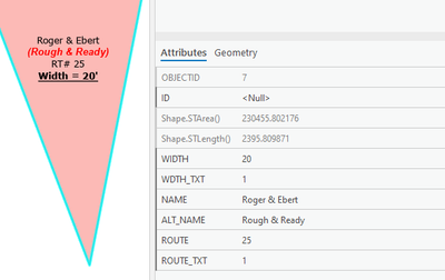

Yes that works the same with the code I just posted earlier and allows the use of the "&".  The issue is that it won't allow me to work with Itallics or font changes and that was the issue.  I can get away using the code I had, or the one you posted just fine, but I won't have the ability to work with that functionality.
  Again, it's more just visually appeasing, and not something I really need, but it would be nice to see if it could work with that sort of thing.

Here's the full code using your example and the itallics and font size changes where having a "&" in the name, still causes that issue displaying the code for itallics, etc as the original issue had.  Removing those of course works fine, but I don't get this added visual possibilities is all...

If you use text formatting tags anywhere in the labelstring, you need to put the replace function back in there to replace any '&' with &amp; as below:

This example shows changing font size, color, and making bold.  the <ITA> tag, even though Pro's documentation says it works, DOES NOT WORK in either of my versions of Pro (2.9.3 or 3.0.3).  However, if you look at line 21, I call out the font as Arial Italic so it displays as such.
Maybe you could contact tech support and see if there is some trick to getting the <ITA> tag to work, but suspect it is a bug.  Otherwise, if you want italics, you will need to find a font that lets you declare it as above.
R_

Very odd.  So I have tried your code and I get it to work, all except when there is only the NAME being displayed.  Then it fails with the '&' and prints out the following:
"TEST & TEST" will show up as "TEST &amp: TRUE"
  Now if I add an ALT_NAME with or without the '&' it displays both perfectly fine.  Or if I add a ROUTE or WIDTH (other than what is in the exclusion) it works perfectly fine.  So just the NAME with the '&' fails.  This is getting pretty close to the fix though.
  On another note, being on 3.0.3 myself.  I did try with the <ITA> just to see if I get the same issues you did, and I am getting it working for me the exact way you used <BOL>.  So odd you aren't getting that working like I am...
