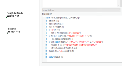

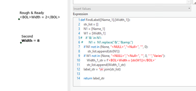

It appears as if 2.9.3 won't honor the <ITA> tags, so was getting nowhere.  However, I decided to replace the italics tag with <BOL> tags for testing.
However, according to this page,   "The ampersand (&) and angle bracket (<) are special characters and are not valid in your text if formatting tags are used. Use the equivalent character codes &amp; and &lt; instead.
Annotation
Instead of <ITA>John & Paul</ITA>, use:
<ITA>John &amp; Paul</ITA>
So, will have to look for the special character, and if there, replace with &amp;.
With lines 5 and 6 commented out:
Then, uncommented:
Hope this helps figure out what is going on.

Ok I got the Name part working with the & which is great and thank you for that.
