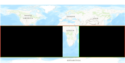

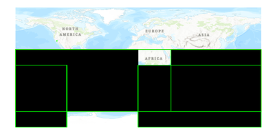

When I check "Include ground track", it executes without error but the layer includes only the blurry view from before, though it allows zooming now. It also includes several odd large rectangles across the world map.

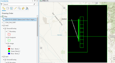

One of the issues I am having is that the KML to layer tool is not working. Here is the output for the tool when 'include ground track' is selected. The file I am opening is a small georeferenced png in California's central valley, and the coordinate systems of the KMZ and output layer match, so I have no idea why the output looks like this.

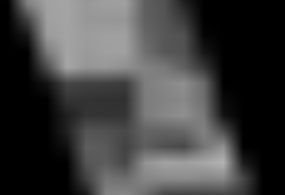

Here's the output from one of my test runs of the tool at different scales. Both the input kmz and output layer are in WGS84, and the image is displaying in the correct location. However, it remains very blurry as you zoom in further:

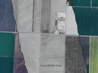

As you can see on Google Earth, the image should be much higher resolution:
