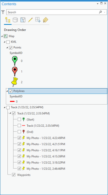

  1. Use the Tool KML to Layer to convert the KML/KMZ data to a file geodatabase
  2. Result: the data from the KMZ (Track…) is converted to a file geodatabase KML.gdb and added to the TOC:

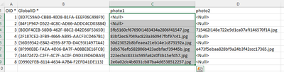

  2. Add new sheet “attachments”
  3. Select all data in “Sheet1” and copy as values to sheet “attachments”
  4. In sheet attachments remove all columns except [OID*], [GlobalID], [photo1] and [photo2]
  5. In columns [photo1] and [photo2] correct the few filename extensions.
  6. Add <Null> in de cells that are empty, i.e.:
  1. Save your excel

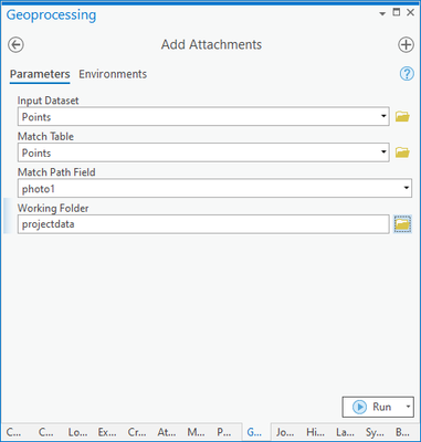

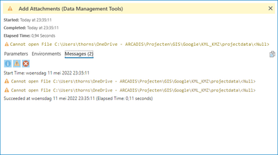

Import attachments

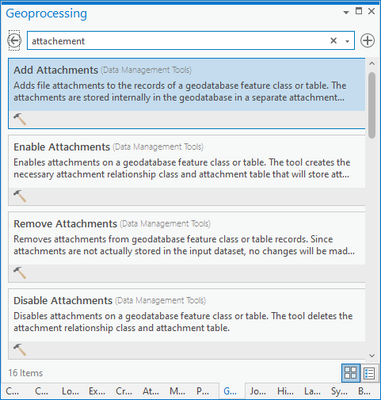

  1. Tool ‘Add Attachments’
  1. Import photo1
  1. For the <Null> values you will get error messages or when a filename is not correct.

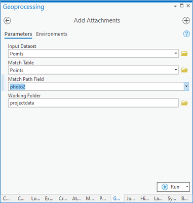

  1. Import photo2
    1. For <null> values you will get error messages

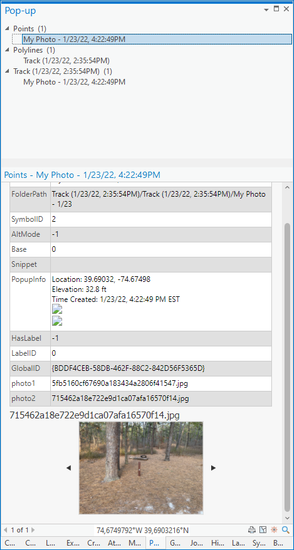

popup from the KML data opened in ArcGIS Pro
popup from the data converted to file geodatabase
