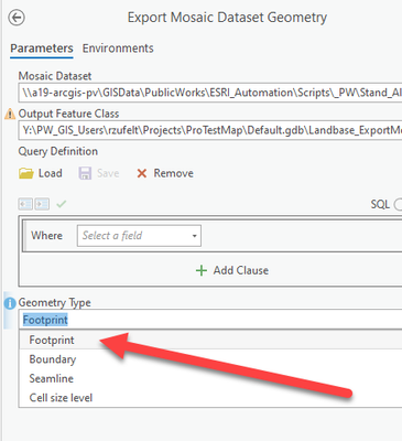

If you export Footprint instead of Boundary, you get the footprints (polygon outline) of each tiff in the mosaic:

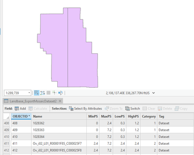

With just footprints, I get something like this as I also have overviews in my mosaic:

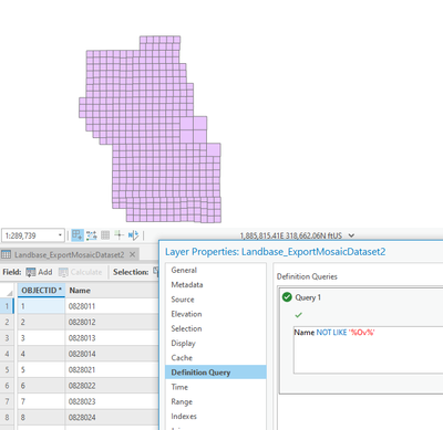

If I put a definition query on it to not show the overviews, all I get is the footprints for each tiff:
Which could then be exported to new FC without the overlapping overview polygons.
