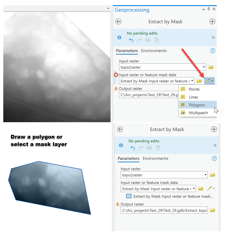

extract by mask
you can draw a polygon or select a pre-drawn featureclass

If you have the shape in the form of a polygon feature layer, you could use Clip Raster (Data Management).
Output Extent: Feature Layer
Check "Use Input Features for Clipping Geometry"
