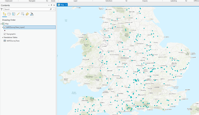

So following the instructions here I connect with an OLE connection to an Access database (accdb). I add the table to the map and then create an event theme from it, so far so good, as shown below.
Using the select tool I draw a selection box around 1 point on the map an I see this...
All points selected!

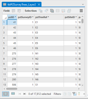

So I open the attribute table of the event layer and I see this...
Nothing is selected!
