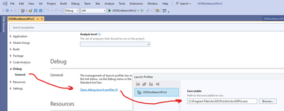

Since you are talking about Development in Visual Studio, it sounds like you need to setup your debug environment to launch and run ArcGIS Pro. Using the debug environment gives you the ability to do 'hot reload' of code so you can edit 'most' forms and modules without restarting ArcGIS Pro, secondly recall that you need to update the config.daml <Date>02/04/2025 10:45:00 AM</Date> tag every time you rebuild and deploy your add-in.
In Visual Studio you need to setup you test environment. In your .\properties folder in your project you should have a launchSettings.json file with the following:
"profiles": {
"NameOfYourAddIn": {
"commandName": "Executable",
"executablePath": "C:\\Program Files\\ArcGIS\\Pro\\bin\\ArcGISPro.exe",
"commandLineArgs": ""
This can be SET in Visual Studio with Project Properties -> Debug -> Open Debug Launch Profiles -> New Profile -> Executable.
