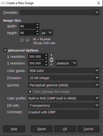

Does anybody know if there is information on best practices or maximum limits on how to create/design a SVG to be used to import for Shape Marker in the Style file within ArcGIS Pro 2.4?
I was hoping for some of the information would be around
  • Use an application like Adobe Illustrator, GIMP, Inkscape, etc. to create your files
  • Size no greater than 96 x 96px, etc
  • Only use 32bit colour
  • Background generally should be 'Transparent'
  • Don't use colour gradient fills
Here is an example of setting to enter when creating a new image with GIMP
Thanks
